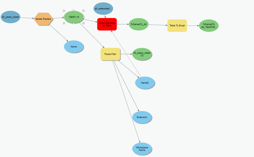

I solved the problem by renaming the output of the parse_path to Name2

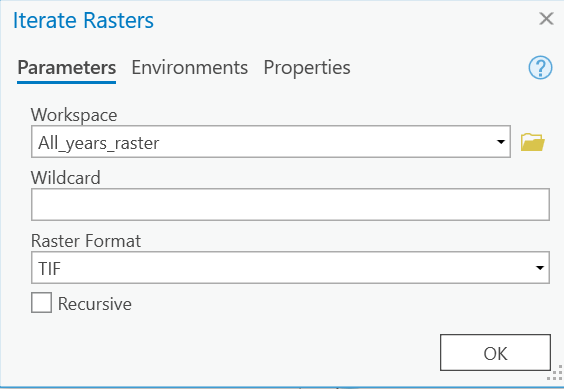

but in the iterate rasters, only use the first raster and does not iterate over the other rasters in that folder. The iterate rasters looks like the following image

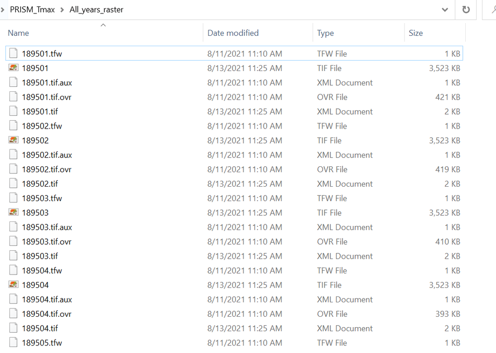

and my folder I am sure that has more than 1 raster file as shown in the image below
Do you know why iterate only over the first raster file?

Great to hear you got this thing running. I don't know, I would make sure you validate the model before you re-run it. Your model looks like it should run correctly. You may want to try "turning it off and turning it on again" -- ie restart Pro. Often that fixes things for me when things do not run as they should!

Good solution removing the space. This can happen with the Spatial Analyst tools - they often bail on names, layer names, or even paths with spaces or any special characters.
