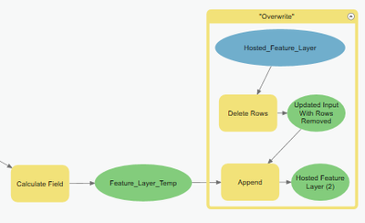

Combine Delete Rows and Append tools to make a single Overwrite tool to be used in ModelBuilder.  (a no code solution)
For background I have a Hosted Feature Layer, that is overwritten daily.  The data is coming from a CSV that gets processed in ModelBuilder.

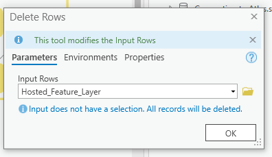

1st Delete Rows removes all records from the Hosted Layer

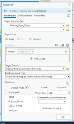

2nd Append the Hosted_Feature_Layer with the processed Feature_Layer_Temp
Every time the model runs the entire Hosted Feature Layer is refreshed with new data from the processed CSV.  The Hosted Layer id stays the same, so no need to reconfigure anything consuming he layer.

Our sharing team published this blog with a sample of how to overwrite in a model https://www.esri.com/arcgis-blog/products/arcgis-pro/mapping/publish-and-overwrite-web-layers-in-mod...
For what you're describing though, have you simply tried using the Truncate Table tool rather than Delete Rows? https://pro.arcgis.com/en/pro-app/latest/tool-reference/data-management/truncatetable.htm
That will solve your stated problem of the objectid not resetting (as long as it works on your hosted feature service).
