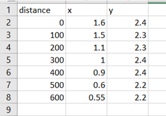

I could just generate a series of points with regular spacing along the river, get the geometry(x y locations) of each point, and match it to the distance. it would look something like this:(which you could just match against in a spreadsheet if that's easier for you)
