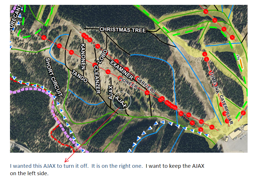

I am trying to turn off one of the label called AJAX and it has two in one line.. I wanted that AJAX to be turn off and keep the one on the other side...
See the screenshot...
How do you do that in SQL Query to tell that to ArcMap ?

If you check Remove duplicate labels (as in the picture), You will not need to use SQL query.
DEAF_PROBERT_68
Honored Contributor
Thanks ! That worked !
