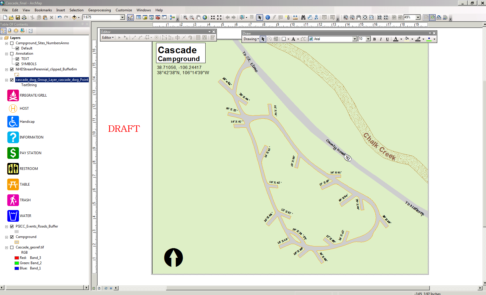

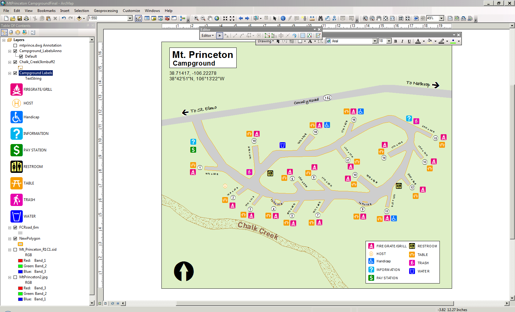

I am trying to import a layer file I save as "Save As "Layer file" from  another layer that I set it up as a Campground Labels. I do not know why when I am working on another Campground and the labels should be the same; however, I am aware that they have different extent system. What might go wrong ? Do the attribute tables have to be the same  as others ?  Currently I am doing in Citrix .
This is the sample of the Legend I am working from Campground Mt. Princeton.
A different Campground and this one does not show up the legend as it should be ?

I suspect that your attribute table is missing the same information for the new campground.  I would compare the 2 attribute tables for each feature class to insure that the data is the same to start with.

I got it figured it out. I do know why. The Attribute do not match , so when I fixed it. They showed up now.
