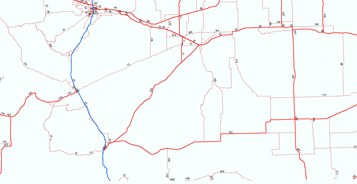

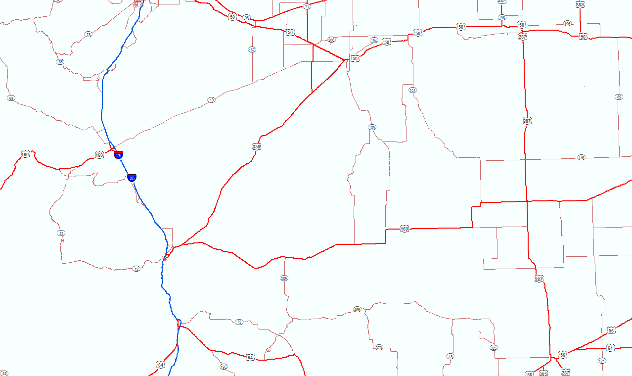

Here is the example of what I am talking about :
Original layer
Clipped   layer with
