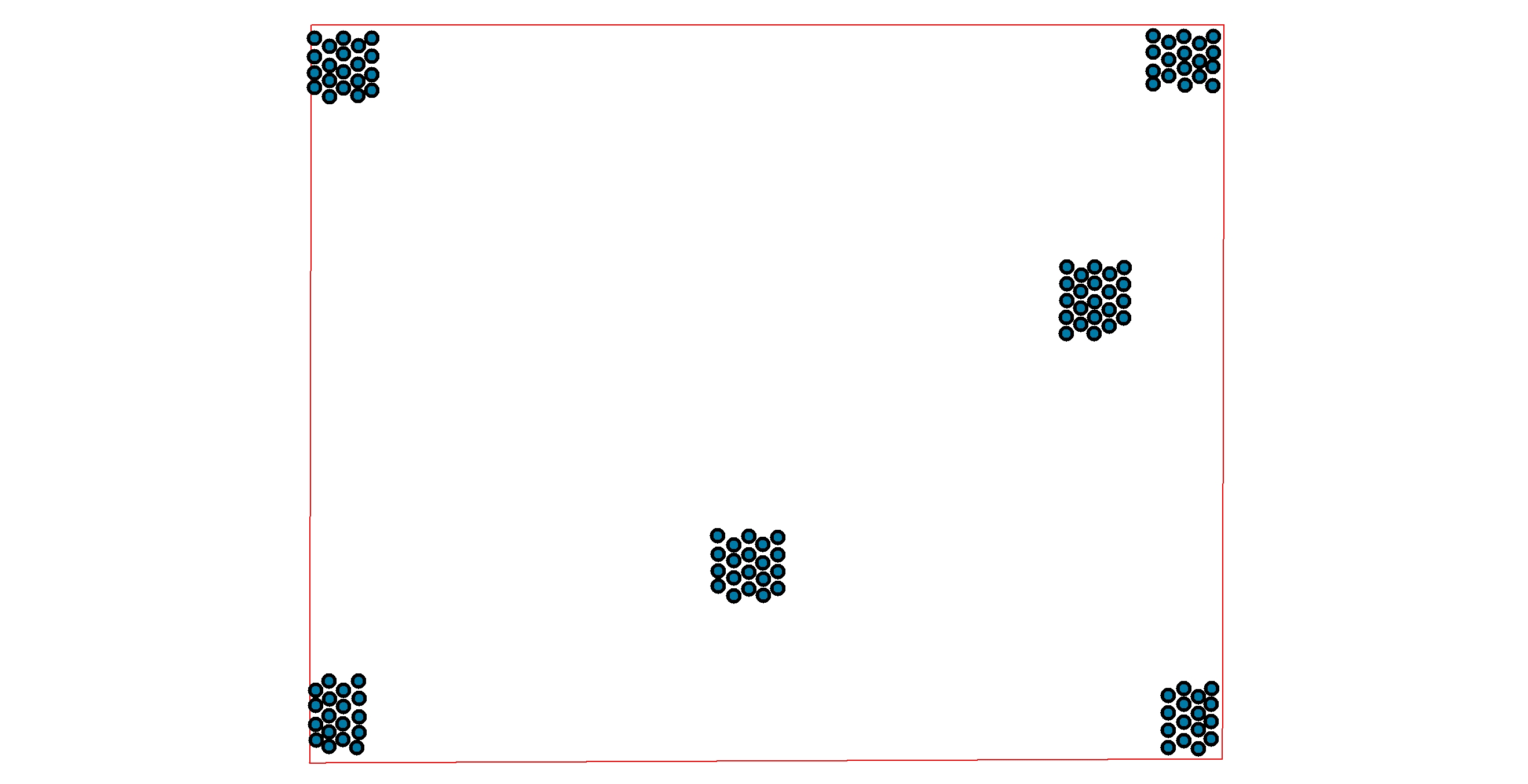

I have points data which represent infected palms in block plantation. I want to analyze whether the infected palms are random, dispersed, or dispersed distribution.
I thought the extension of spatial statistic in ArcInfo could help me to measure the distribution. But I doubt the result, when I creating dummy data (clearly clustered distribution) and I execute with Average Nearest Neighbor tools, the result is at dispersed distribution!
I attach my dummy data here.
If anyone could give me suggestion, it would be appreciated.
Thanks
-anggi

from the average nearest neighbour how it works section,
you observed average nearest neighbours is going to be small relative to the expected
ANN = Do/De  < 1 clustering, > 1 dispersed
​De depends upon area... what is your area?  you have a bounding rectangle but was it used as the extent for the analysis?

Thanks for your suggestion. I have tried to execute once and in environment work, I put my extent area. It works. The result is at clustered distribution.
I thought why my first trial failed was because i didn't put my extent, I only fill the area (optional) with my hectare area.
