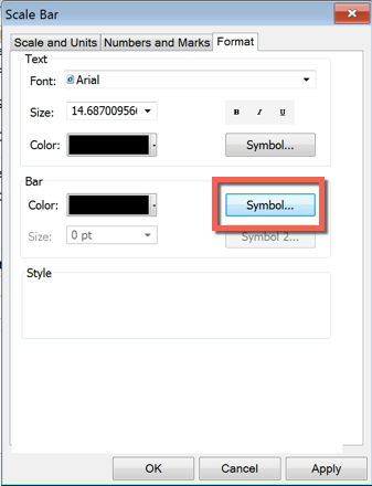

You can create the double scale bar by adjusting the line.
1. Scale Bar > Format > Symbol...

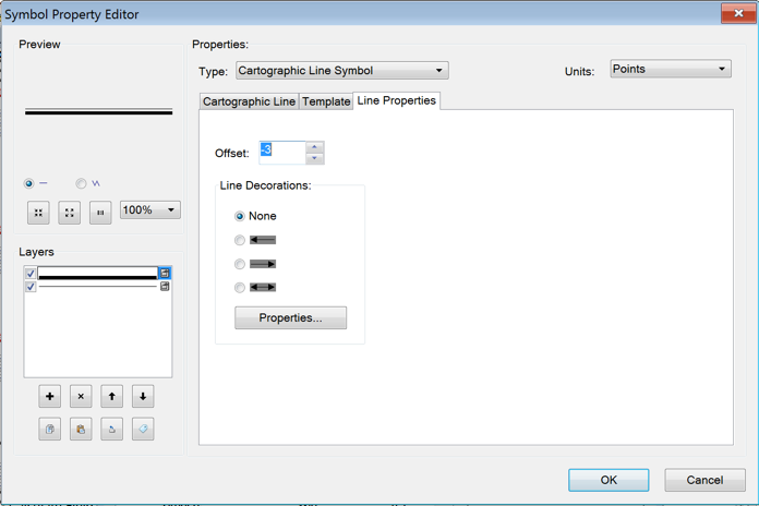

2. Select the Double, Graded line > Edit Symbol...
3. Adjust the offsets of each line to place them where you want them.
