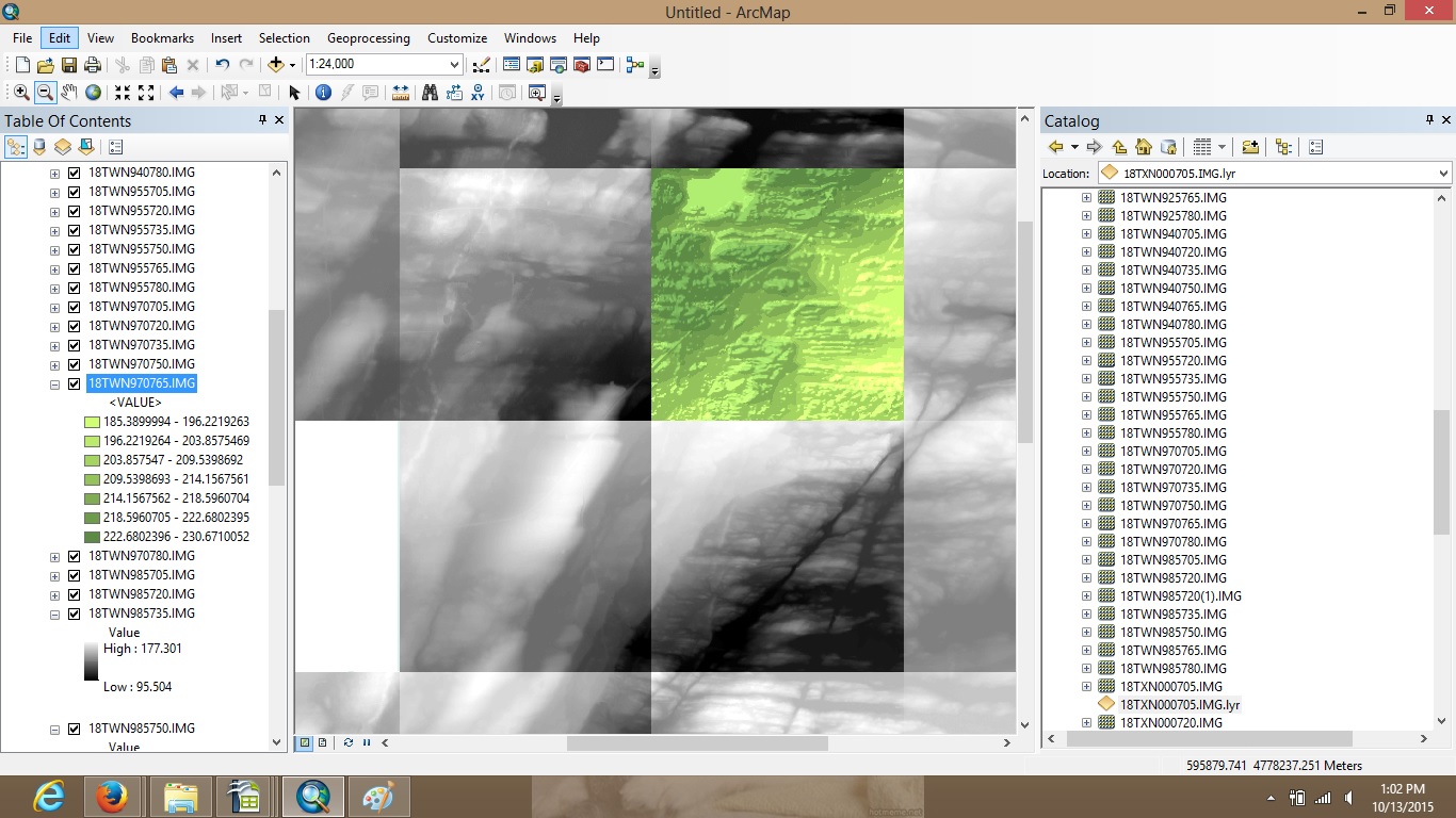

I have 36 tiles of DEM data that together make a regional frame of raster data that I'm working with to build a trail map. I want the final map to show a sense of elevation change by color ramp style and hillshade (also contour lines, but that's not in question right now). I've established the color ramp style and hillshade value for one tile that I'd like to impose onto all other tiles.
Is there a tool or method to overlay the symbology layer saved from the primary tile onto all tiles, at once, rather than importing the symbology layer onto each tile, one at a time.

I think your best bet is making a mosaic, and symbolizing it once.
See here for a quick way to do it using the Image Analysis Window: ArcGIS Help 10.1
