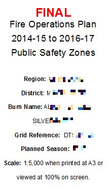

This is what the text box looks like with paragraph text (excuse the pixellation):
Note the rather excessive line gaps (roughly equivalent to 'paragraph' spacing in Word etc) and not being proportional to the font size. In this example, font sizes are set using the <fnt> tags, with the 'base' font size for the text box being set as 8 points.

Check the "Leading" setting in the text element's properties page>Text tab. Also, are you using formatting tags in the text? If so, it looks like the leading is based on the largest font size within the text element. There is a formatting tag for leading, but it also appears to apply to the entire text element. One way to get around that is to break up the text element into smaller text elements, like one for each font size.
AnthonyCheesman1
Thanks David - breaking the text box into 2 smaller boxes has solved the issue. I will also have a fiddle with the leading tag to see if it resolves the issue.
