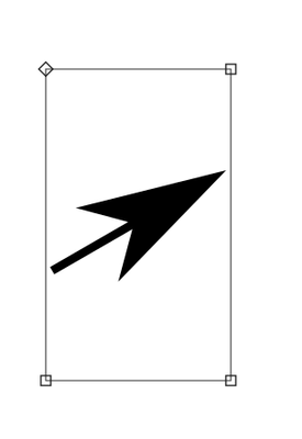

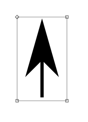

Just a guess, as I'm not using the same software to verify. Perhaps your north arrow has a defined bounding box, and as the arrow rotates within that box, it has to shrink to fit?
Try setting the bounding box of the north arrow to a perfect square, or else choose an arrow style that is not elongated.

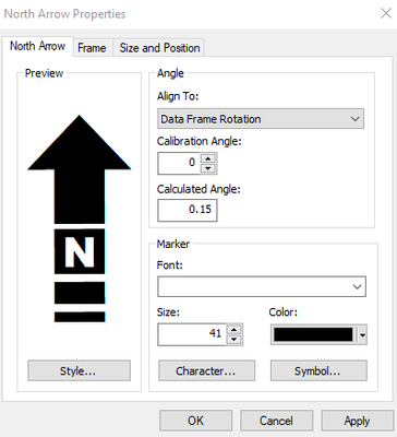

How do I set the shape of the bounding box? Here is the arrow I'm using. At this point changing styles would be problematic as all other maps made for the project use this style.

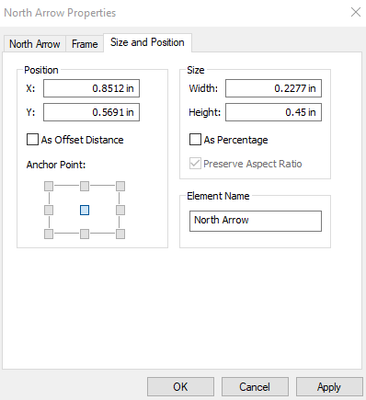

Sorry, "bounding box" is terminology from another program. What happens to your arrow when you change the width/height under Size? I see that the "preserve aspect ratio" box is greyed out, so you may be out of luck.
Could you create a copy of the north arrow that simply has negative space on the sides to make it a perfect square? Of course, this still won't help for diagonals, as the main square would shrink to fit within the original size. If that's what's happening here, which we're still not certain of.
Can you give a few screenshots of what the rotated arrows look like in the output?
