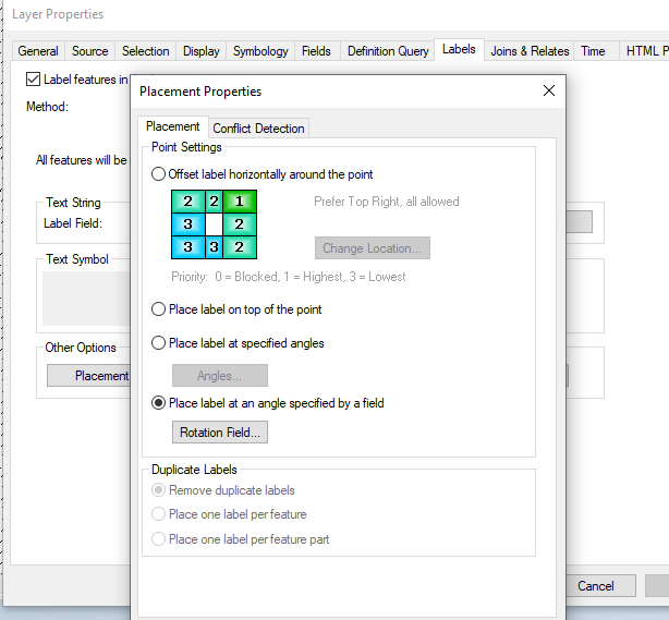

I'm trying to link a Field (that I created within a Layer) where it will change the size of the text just by changing it in the Attributes.
To "link" the Angle, I went to Layer Properties>Labels>Other Options > Placement Properties...>"Place label at an angle specified by a field"
And set it to my "TEXT_ANGLE" field.
How can I do the same for the size?
Any inputs are welcomed. Thank you.
