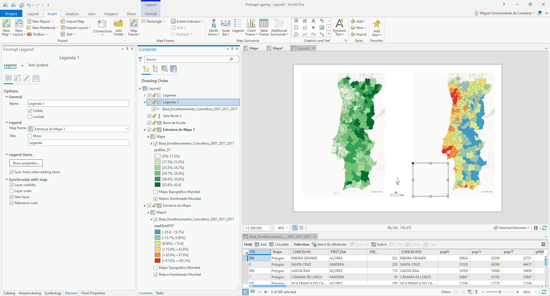

Hi there,
I am an experienced user in ArcGIS 10.2, but recently migrated to ArcGIS Pro.
I am trying to produce two maps (same scale) on the layout view. However, the legends are not displayed. I can only see this: [...]
Here I provide a picture of what is happening. I have looked for information here and there, without success. I suppose I am making a mistake, but I cannot figure out what is wrong.
Any guess?
Thanks in advance,
Best wishes,
Miguel
Print screen: ArcPro not displaying the legends
AubriOtis
Hi Miguel,
The [...] symbol just means there isn't enough space in your legend to show the information. You can try shrinking the font size, or changing the legend fitting strategy. This help topic explains fitting strategies and has steps on how to change fonts: Work with a legend—ArcGIS Pro | Documentation . You can also enable word wrapping, which will put long labels on multiple lines, I find that to be useful when working with legends.

Hi Aubri,
Many thanks for your answer. Problem solved!
