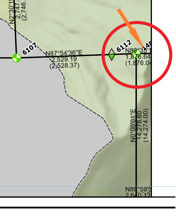

Is there some toggle somewhere that labels a feature if the entire feature is within the defined extent?
I'm trying to set up a map series and the labels of feature that cross the defined extent interfere with the labels of the features that are within the defined extent.  Is there some way of labeling only the features whose entire geometry is contained within the map extent?
The orange arrow points to the line feature fragment that has the label that I'm trying to remove.  It barely shows up inside the map frame extent and so the map engine tries to place the direction and bearing label.  There is a another incident at the bottom right corner.

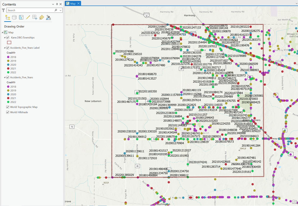

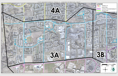

WDMParkPlanner
I have this same question and need. I assume there is an SQL Expression that could do this but I am so inexperienced with those I wouldn't know where to start. For example I would like to have label "3A" remain and not have 4A or 3B show up as those features do not entirely show up within the map extents:
Hope to find something that doesn't involve converting the labels to annotations.
