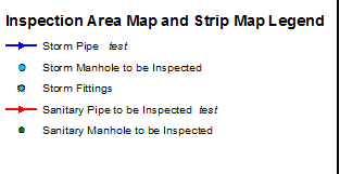

Two features in the legend have an italicized "test" written after them.  This occured after I changed the order of the features in the table of contents.  Any ideas how to get a rid of "test"?  A picture is below showing "test" after Storm Pipe and Sanitary Pipe.legend.PNG

It looks like 'test' may be in the description for your layer. If so, either 1.) delete it from the description, or 2.) change the legend style properties not to show the description.

Hi Karla, so the word test doesn't show up in your Table of Contents, just the legend? Is the text in the legend the layer name, or a label?

Even though "test" was not the layer description, I changed the style in the legend and it worked.
