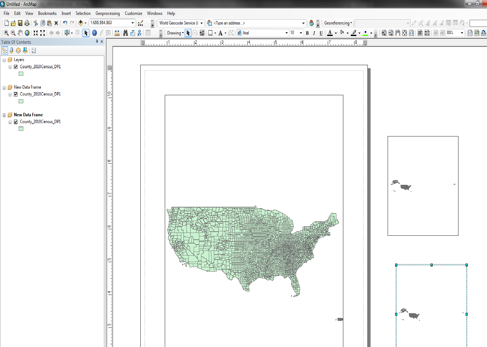

When you are in layout view, you all the objects on the "page" are visible on your map, objects that are outside of the page are not visible(extra text elements, legends, dataframes, etc.)
All you would have to do is select(click) on the dataframes that are outside the page and place them where you want on the map.  You could then zoom to the area you need in those dataframes and create the bounding boxes from the instructions on the blog post.  A template is good so instead of working with a blank map each time, you open a map with multiple data frames with all your layers already loaded and all you need to do is edit it to your purpose.

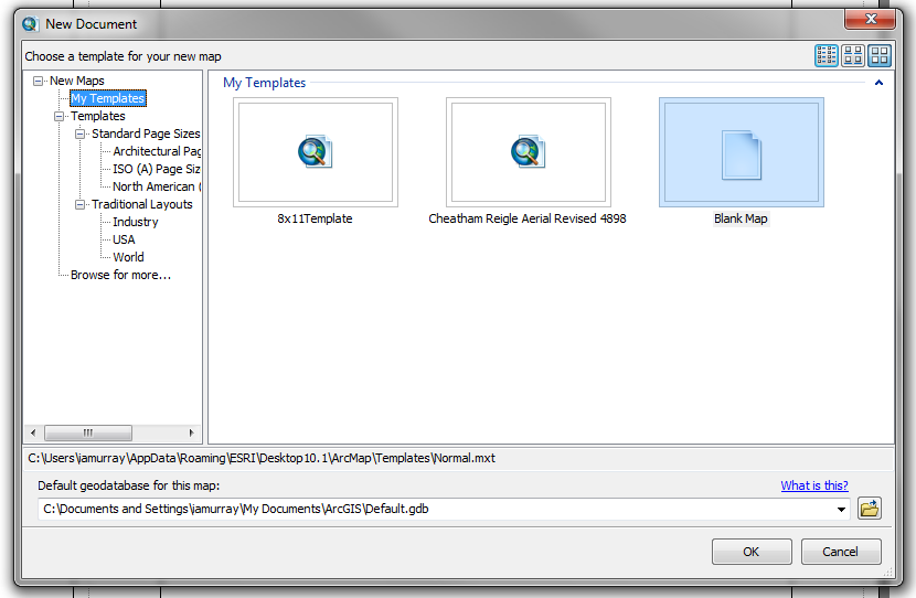

To have a map show up as a template when you open ArcMap, save your mxd file in the C < User < YourUserName < AppData < Roaming < ESRI <Desktop xx.x < ArcMap < Templates folder, the show up like the figure below when you open a  new map document, those are the 3 map documents I have saved there.
If they are in that folder, then when you save, it will automatically treat it as a save as, so you don't overwrite your template on accident
