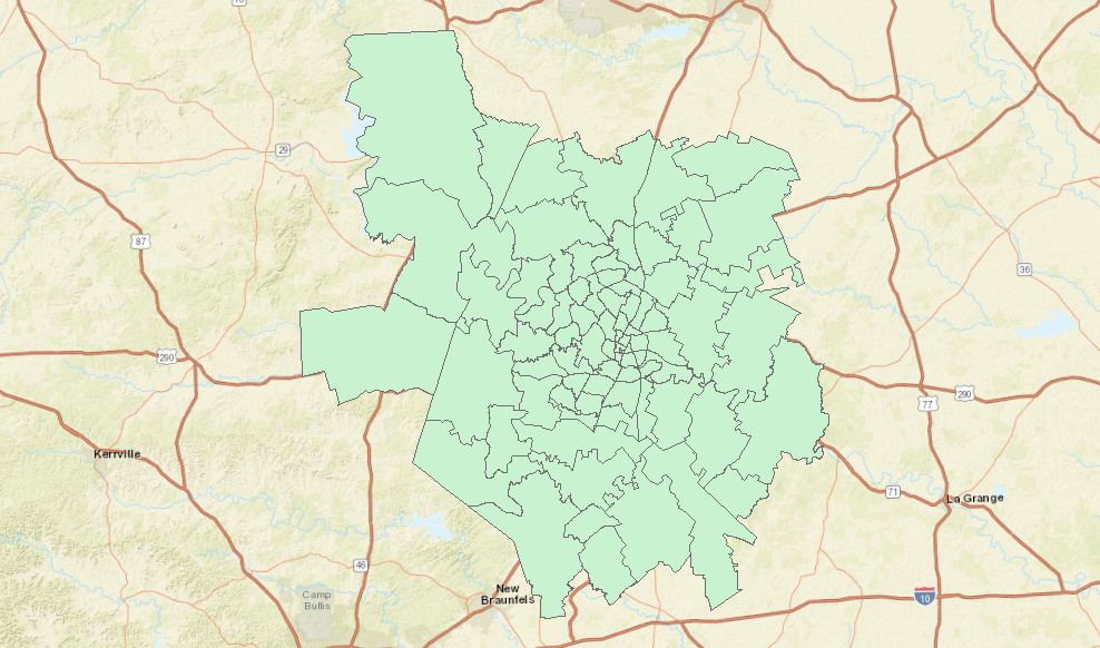

I have loaded the base map. I want  only the area for Austin, Texas to be loaded. Is there a way to cookie cut this out. I don't want to use Bookmark. The polygons are the zipcodes-vector data polygon feature class
See image below.

or perhaps you want to use Clipping the Data Frame—Help | ArcGIS for Desktop
to ignore the stuff outside your area of interest

Are you looking for How To: Clip data to the data frame

Hi Jayanta,
Thanks for your help. It worked. How do then save the clip so that
everytime I load the image it loads faster.

Set up a basemap cache: About ArcGIS caches—Help | ArcGIS for Desktop
