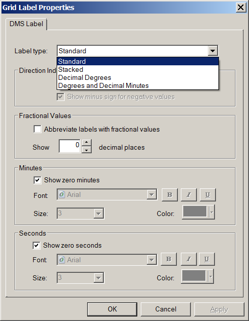

On the labels tab of the grid properties, there is a button for additional properties.
At the top there is a pulldown.
Does this not fix your problem?

In that scenario (using the Additional Properties button and setting it to use decimal degrees or degrees and decimal minutes) you will also need to set the number of decimals to be greater than zero. And even then it drops trailing zeros.

edit: just saw Neil's answer re: graticule label styles, which appears to work, although I could not force it to show decimal places for whole numbers (e.g. 122 vs. 122.00000). If that's not an issue for you, then that should also work. There seems to be more flexibility through grids, however.
