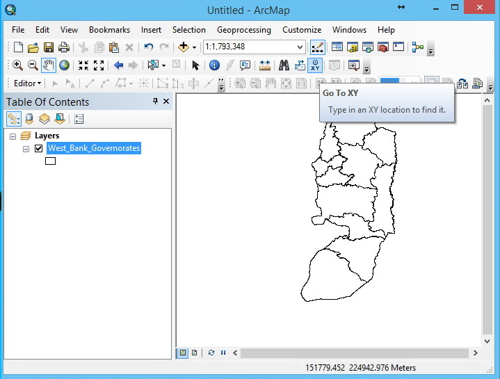

I could not figure out why the "Go to XY" tool does not work, I click on the tool icon, and no thing appears! It was working well with ArcMap 10.2.2 ,What might be the problem here?
Note: Product version is 10.3.0.4322

My guess is that the tool is opening off-screen. When you open the XY tool, look very closely at the edges of your screen for a sliver of new window that you may be able to drag back. Also, see this article for possible fixes to older versions - changing resolution to show more desktop area sounds promising. Otherwise, I suggest connecting to a dual monitor and dragging the window back to the center of ArcMap.

Actually, I've explored the edges and found nothing, also maximized the display resolution but the dialog box did not appear, I will try your suggestion by connecting another monitor and I'll keep you posted

I delete the normal.mxt file from the templates folder, but still the problem is not resolved, I am not able to see the tool's dialog box
