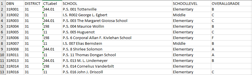

I am looking into public school ratings across the borough of Staten Island, NY. In previous projects, I used census tract data to join a dataset to a shapefile. Since there was only one data point related to any one census tract, it was a pretty straightforward 1:1 relationship. As you requested, here are some screenshots. I'll try to walk through my thought process as best as possible.
This is a sample of the school ratings dataset. The CTLabel column is what I added to enable me to join this dataset to the Staten Island shapefile...

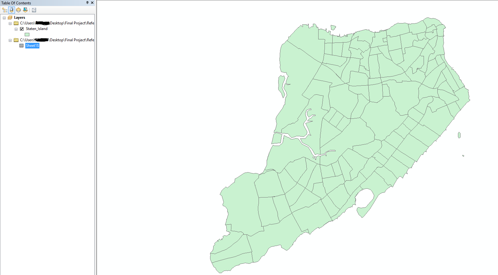

Here is the attribute table for the shapefile...
...and the dataset...

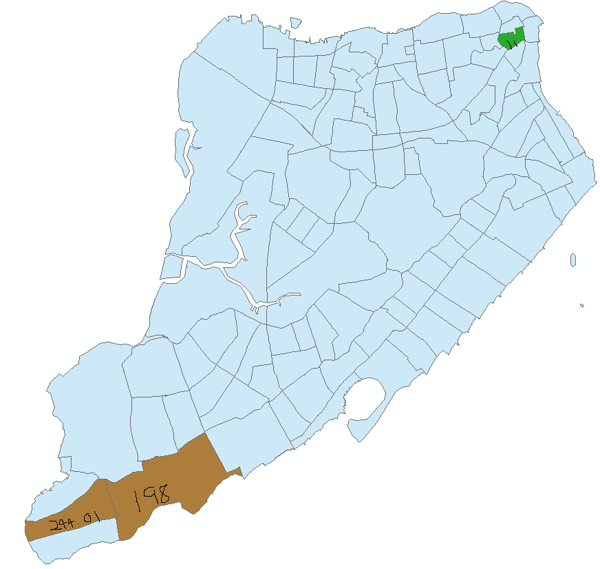

After joining my dataset sample to the shapefile using the 1:1 method, the shapefile now looks like this...
Based on the dataset, the 1:1 join picked up the first B rating in census tracts 244.01 and 198 and the first C rating in census tract 11. It did not pick up any other ratings from those three census tracts. As I understand it, and as I read on ESRI's website: How To: Create a one-to-many join in ArcMap
"For each record in the Main table, if there are multiple matching records in the Other table, only the first matching record from Other is joined."
With this project, it's plausible to have multiple data points (school ratings) within the same census tract. However, it appears the instructions on this page apply to pre-10.4 versions of ArcMap. I attempted to us both the Spatial Join and Make Query Table methods and both did not work for me.
