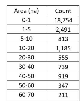

@maherelayyan2  asks:
I want to ask you if you know what is the way to have count of features when i do graduated color classification in ArcGIS desktop not Pro
can i do that without Python , i knew its found in Pro i think dont know if i can do it in arcgis 10.4 to have like the image attached
thanks
curtvprice
MVP Alum
The count is an ArcGIS Pro feature that does not exist in ArcMap. I could suggest adding a field, classifying it, and counting using Summarize.. or the Summary Statistics tool, but adapting your python script to run in ArcMap would probably be easier.
