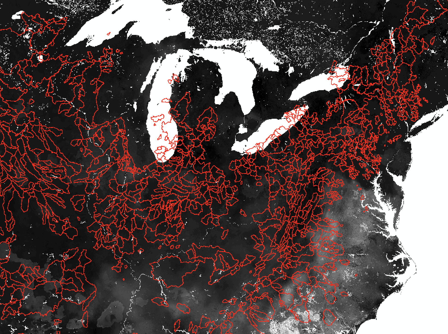

I have extracted a subset of the xarray.Dataset to a raster and this is how it looks. As you can see there are watersheds inside the great lakes. Both raster and shapefile are not in the same coordinate system
I try to put the shape file into the same custom coordinate system of the xarray.Dataset with the following code in python, but with no success.
