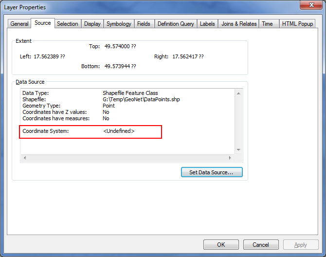

In regards to the projection problem - It sounds like ArcMap does not know what coordinate system your data is in.
If you view the layer properties for your data points can you check if the coordinate system:
If this has not been assigned to the layer then ArcMap will not know how to project the data or do on-the-fly transformations. If this is the case the Coordinate System will show <Undefined>.
You can use the Define Projection tool to assign the WGS 1984 Geographic Coordinate System to this layer (ArcToolbox: Data Management Tools > Projections and Transformations > Define Projection).
After defining the projection the layer properties should have been updated:
You should now be able to project your data points to S-JTSK using the Project tool (ArcToolbox: Data Management Tools > Projections and Transformations > Feature >Project):

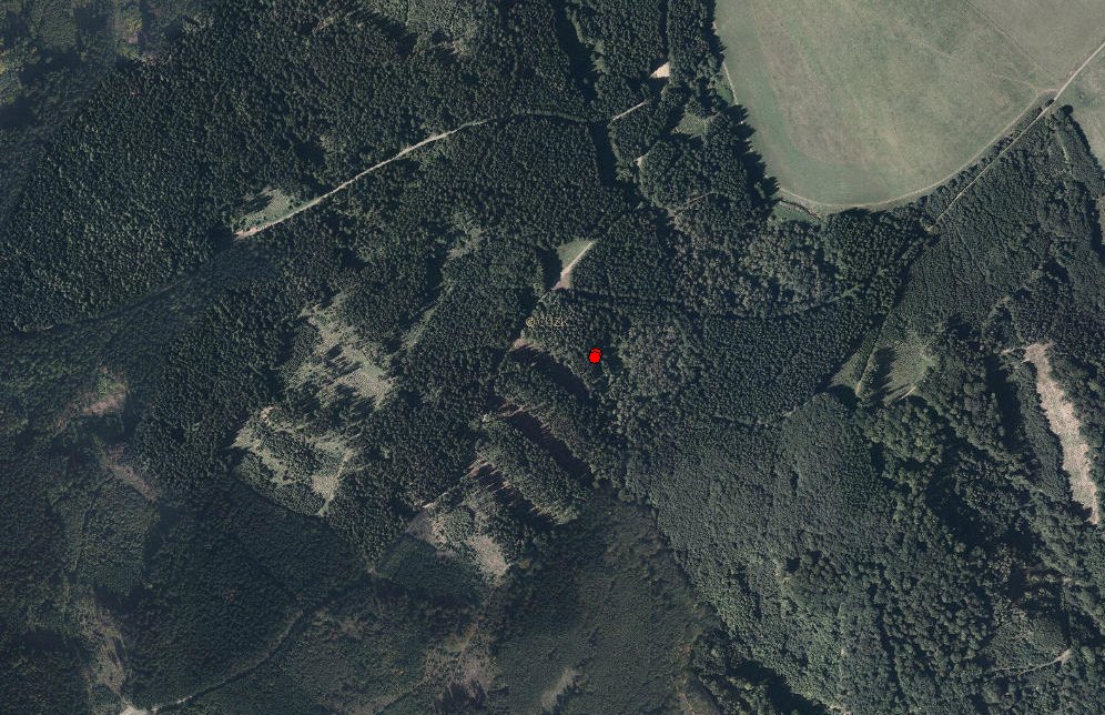

Hello Melita, I don't know about other countries, but Krovak system actualy works in third quadrant and both axis are negative and moreover y axis is in the position of the usual x axis and vice versa. Anyway, I tried to create a point .shp out of coords with inverted x and y coords and, wait for it, it worked. So, thanks for the tip and thank you all who contributed to the overall success.
It just took me 3 and a half year to get i right.............not bad
And here's a proof that it actually works.
