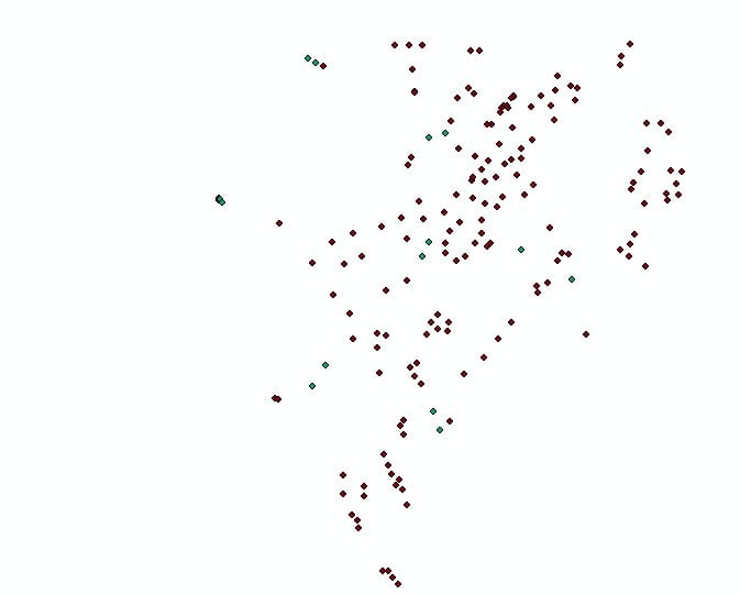

I have a group of points (point shapefile) that I collected in the field. They all has position relationship though  they don't contain information about their global coordinates (I didn't have gps unit for that task). However I have cerated 2 points which I also measured their actual coordinates via my personal gps unit. Now I heard it is possible to give the whole project a coordinate system on the basis of several measured coordinates. Ok, maybe 2 coords are not enough, but I can't find any tool to do it anyway.
Now I don't think it would help to add images but to give a general infromationgroup.jpg
this is (one of) the group of points
there are coords (in the 2 lines from above).
I know the whole post doesn't make much sense but still, if anyone has a clue how to proceed, I'd be grateful.

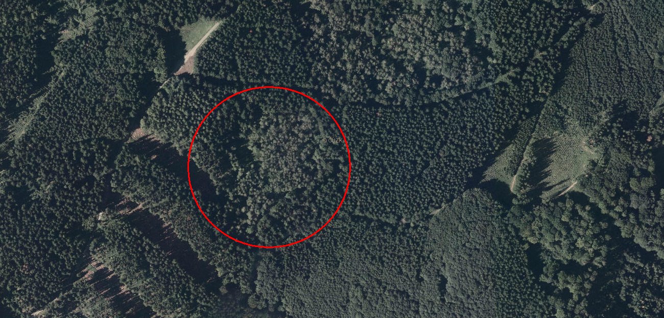

Well, that fast reply I didn't even hoped for. To be honest I am not clever of either one of your advices. Though I have today watched a video on youtube about addin lat and lon fields into an attribute table. However I don't quite ge it. How does the program creates the values of lat an lon when there is only a graphical expression of the data but no coordinates - when I open an attribute of one of those layers, it does not contain any x and y values whatsoever. That is beyond my understanding - how is the data stored in the shapefiel when there is no relationship stored in the attribute table...(probably another story) and if you ask if I do have the data for all the points, yes I do. I just don't understand how it can split without corrupting the shapefile.
Now, I tried to calculate the x and y coords for my layer with set coord system for data frame as shown below but the point should, in my opinion, show in the red circle in the second image. To make everything clear I tried to join two attribute tables - the one of a shapefile and the other containing data for the points (exported database). However with no happy end except the join itself.
