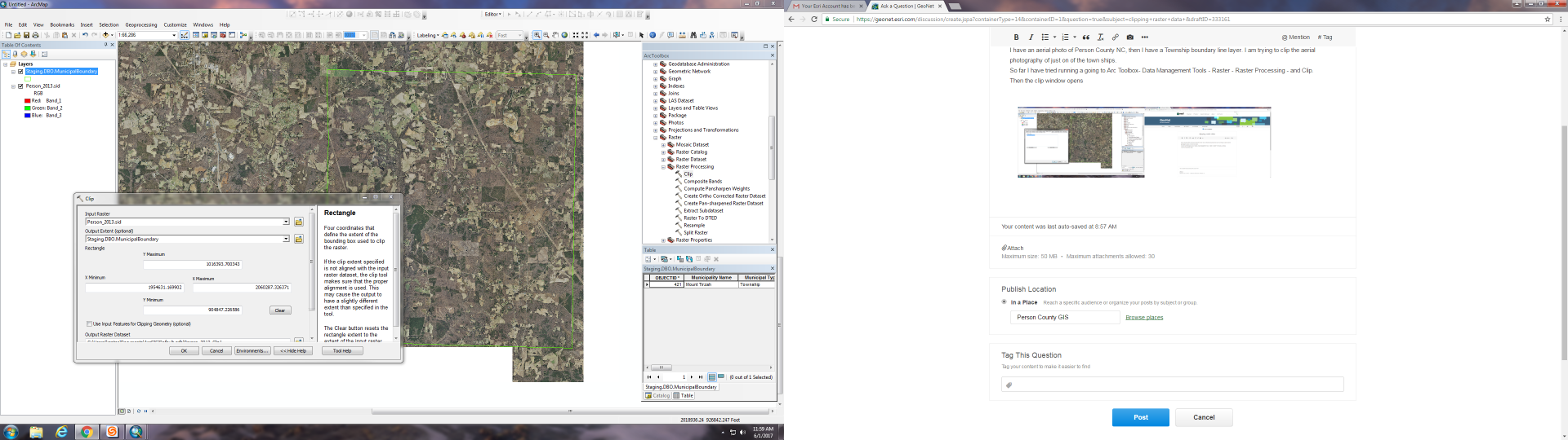

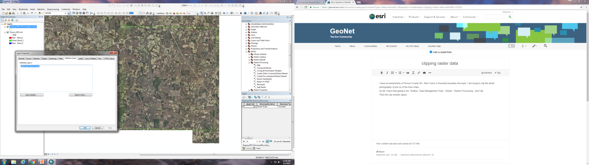

I have an aerial photo of Person County NC, then I have a Township boundary line layer. I am trying to clip the aerial photography of just on of the town ships.
So far I have tried running a definition query to only show desired township then I went to Arc Toolbox- Data Management Tools - Raster - Raster Processing - and Clip.
Then the clip window opens I select the raster aerial photo as the Input Raster and The township boundary as the Output Extent.
When I run the Clip nothing seems to happen.
Please help.
