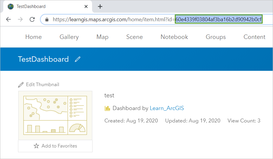

1. Go to ArcGIS Online and sign in with your source ArcGIS account—the one that contains your content.
2. Click the Content tab and locate the item you want to copy. Click the item name to open the item details page.
3. Copy the id from the address bar in your browser. This is the long string of numbers and lower-case letters that appear at the very end of the URL. Do not include id=.
4. Paste the id into a note or other temporary document.
5. Find any other items you want to move. Copy the id for each.
