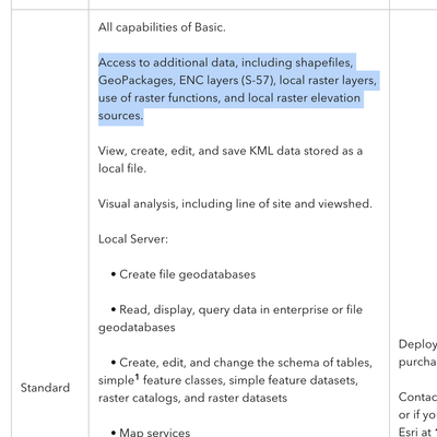

Here is a screenshot of the relevant section from that doc
DiveshGoyal
You need a Standard license to work with local tiff data (raster)
