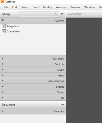

and then start SceneBuilder you will hopefully see MapView and SceneView as custom controls.

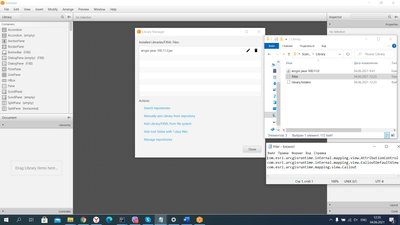

VanyaIvanov
Thank you. I've added this lines into filter.txt but nothing changes. I still have only AttributionControl

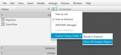

ColinAnderson1
I placed filter.txt (with the lines from above) and arcgis-java-100.11.0.jar into SceneBuilder's library location and I could see MapView and SceneView as custom controls. Maybe try deleting SceneBuilder's library and starting again. I think if you have the filter correct then you should not see AttributionControl in the custom controls.
I will see if I can find someone else to verify that this works just in case I have missed something. You could also check what SceneBuilder says in the JAR report e.g.
From that same menu you can also confirm the library location.

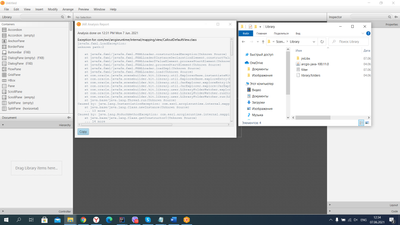

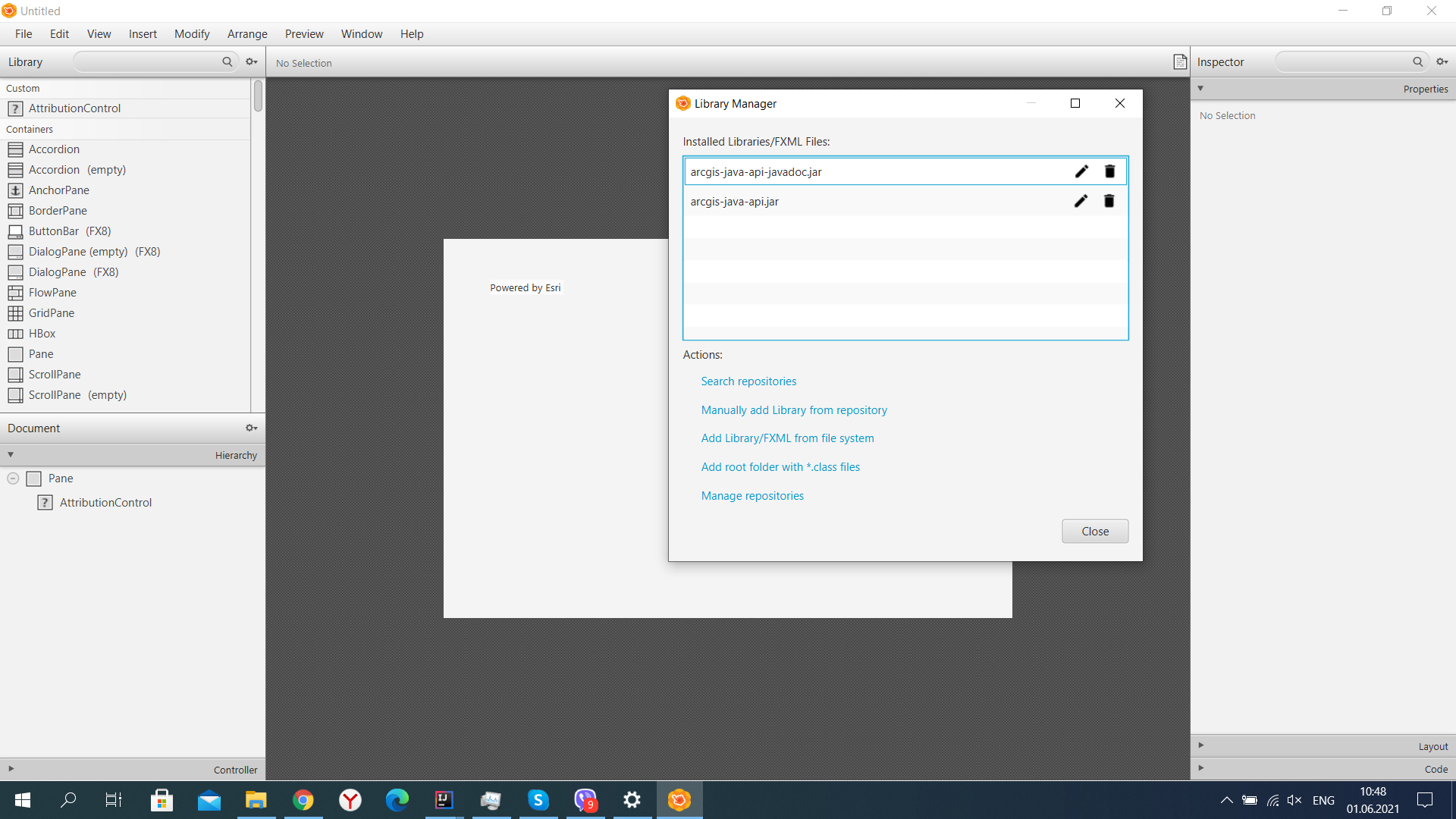

VanyaIvanov
Thank you.
After reinstallation of the Scene Builder, adding of the arcgis-java-100.11.0.jar to the Library folder and adding of this lines into filter.txt i dont see AttributionControl but neither i see MapView or SceneView.
 My jar Report:

at com.oracle.javafx.scenebuilder.kit.library.user.LibraryFolderWatcher.run(LibraryFolderWatcher.java:100)
at java.base/java.lang.Thread.run(Unknown Source)
Caused by: java.lang.InstantiationException: com.esri.arcgisruntime.internal.mapping.view.CalloutDefaultView
at java.base/java.lang.Class.newInstance(Unknown Source)
... 13 more
Caused by: java.lang.NoSuchMethodException: com.esri.arcgisruntime.internal.mapping.view.CalloutDefaultView.<init>()
at java.base/java.lang.Class.getConstructor0(Unknown Source)
... 14 more
Exception for: com/esri/arcgisruntime/mapping/view/MapView.class
java.io.IOException: java.lang.NoClassDefFoundError: Could not initialize class com.esri.arcgisruntime.internal.jni.CoreMapView
at com.oracle.javafx.scenebuilder.kit.library.util.ExplorerBase.instantiateWithFXMLLoader(ExplorerBase.java:60)
at com.oracle.javafx.scenebuilder.kit.library.util.ExplorerBase.exploreEntry(ExplorerBase.java:111)
at com.oracle.javafx.scenebuilder.kit.library.util.JarExplorer.exploreEntry(JarExplorer.java:83)
at com.oracle.javafx.scenebuilder.kit.library.util.JarExplorer.explore(JarExplorer.java:65)
at com.oracle.javafx.scenebuilder.kit.library.user.LibraryFolderWatcher.exploreAndUpdateLibrary(LibraryFolderWatcher.java:367)
at com.oracle.javafx.scenebuilder.kit.library.user.LibraryFolderWatcher.runDiscovery(LibraryFolderWatcher.java:155)
Caused by: java.lang.NoClassDefFoundError: Could not initialize class com.esri.arcgisruntime.internal.jni.CoreMapView
at com.esri.arcgisruntime.mapping.view.MapView.create(MapView.java:93)
at com.esri.arcgisruntime.mapping.view.MapView.<init>(MapView.java:87)
at java.base/jdk.internal.reflect.NativeConstructorAccessorImpl.newInstance0(Native Method)
at java.base/jdk.internal.reflect.NativeConstructorAccessorImpl.newInstance(Unknown Source)
at java.base/jdk.internal.reflect.DelegatingConstructorAccessorImpl.newInstance(Unknown Source)
at java.base/java.lang.reflect.Constructor.newInstanceWithCaller(Unknown Source)
at java.base/java.lang.reflect.ReflectAccess.newInstance(Unknown Source)
at java.base/jdk.internal.reflect.ReflectionFactory.newInstance(Unknown Source)
at javafx.fxml/javafx.fxml.FXMLLoader$InstanceDeclarationElement.constructValue(Unknown Source)
at javafx.fxml/javafx.fxml.FXMLLoader$ValueElement.processStartElement(Unknown Source)
at javafx.fxml/javafx.fxml.FXMLLoader.processStartElement(Unknown Source)
at javafx.fxml/javafx.fxml.FXMLLoader.loadImpl(Unknown Source)
at javafx.fxml/javafx.fxml.FXMLLoader.load(Unknown Source)
at com.oracle.javafx.scenebuilder.kit.library.util.ExplorerBase.instantiateWithFXMLLoader(ExplorerBase.java:56)
... 7 more
Exception for: com/esri/arcgisruntime/mapping/view/Callout.class
javafx.fxml.LoadException:
unknown path:2
at javafx.fxml/javafx.fxml.FXMLLoader.constructLoadException(Unknown Source)
Caused by: java.lang.InstantiationException: com.esri.arcgisruntime.mapping.view.Callout
... 13 more
Caused by: java.lang.NoSuchMethodException: com.esri.arcgisruntime.mapping.view.Callout.<init>()
... 14 more
Exception for: com/esri/arcgisruntime/mapping/view/SceneView.class
java.io.IOException: java.lang.NoClassDefFoundError: Could not initialize class com.esri.arcgisruntime.internal.jni.CoreSceneView
Caused by: java.lang.NoClassDefFoundError: Could not initialize class com.esri.arcgisruntime.internal.jni.CoreSceneView
at com.esri.arcgisruntime.mapping.view.SceneView.create(SceneView.java:74)
at com.esri.arcgisruntime.mapping.view.SceneView.<init>(SceneView.java:68)
... 7 more
ColinAnderson1
Hi,
The error output indicates that the native libs for runtime cannot be found when SceneBuilder tries to construct the controls. One way to fix that would be to copy the jniLIbs folder into SceneBuilder's library folder.
Colin
VanyaIvanov
I did it but nothing changed, Jar Report is the same.
ColinAnderson1
Sorry, slight correction - jnilibs needs to go where the JAR report says it is looking for it. In your case this is C:\Users\osipa\AppData\Local\SceneBuilder.
Colin
VanyaIvanov
Thank you. It works!
