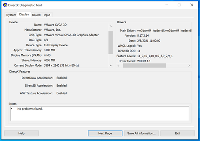

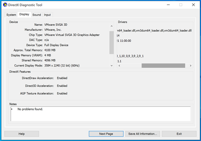

Looking at the crash dump, it has certainly tried to create the context and is making its initial draw to the rending context, but this has failed.  I've seen this happen when there is something wrong with the DirectX 11 drivers.  The dxdiag tool should tell you the level of DirectX support you have.
ArcGIS Runtime SDK is designed to use DirectX11 WARP if there is no graphics card.  Often there is no graphics card on VM environments, so this allows for software rendering.
The issue could be that VMWare Fusion has an issue supporting some of the DirectX functionality we are calling or the drivers need updating.

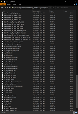

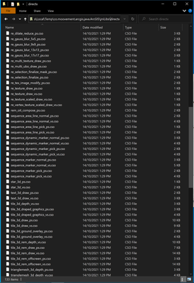

Another thing you could check is if the DirectX shader files we supply with the SDK are present and correct as in the deployment section:
https://developers.arcgis.com/java/license-and-deployment/deployment/
The shaders will be in the jniLibs/directx directory.  These are needed for running the apps on Windows platforms.

There isn't a way of forcing it to use software rendering.  When we are creating a DirectX rendering context, we query the capabilities of the system and if it reports there is a supported graphics card we use it.
In this case the system is reporting DirectX hardware support but I wonder if there is a driver issue with this virtual environment.

There could be a driver issue but other DX11 software runs perfectly - including a game model rendering engine.

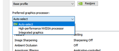

Update: I wonder if the DirectX capability detection used by the runtime has some issues. I have another test user who experiences extremely poor performance any time the map view updates despite having a very capable laptop. In this particular case the laptop has dual GPUs, an Nvidia discrete mobile GPU and an Intel 630 CPU-integrated GPU. The runtime seems to always select the integrated GPU but is also melting the CPU leaving the discrete GPU idle. If you pan the map view while a heatmap is displayed there is a pause of up to a minute while the heatmap rerenders.
ColinAnderson1
For this case there is usually an option in the Nvidia settings to choose which graphics card to use. I think it is also possible to disable the built in Intel graphics - possibly at the driver settings level or in the bios.
