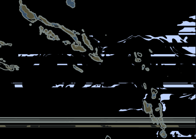

I have tried using a tiled layer loaded from a file to create the basemap and while this did allow me to scroll between charts, it also caused significant rendering errors while displaying those charts, as shown below:
