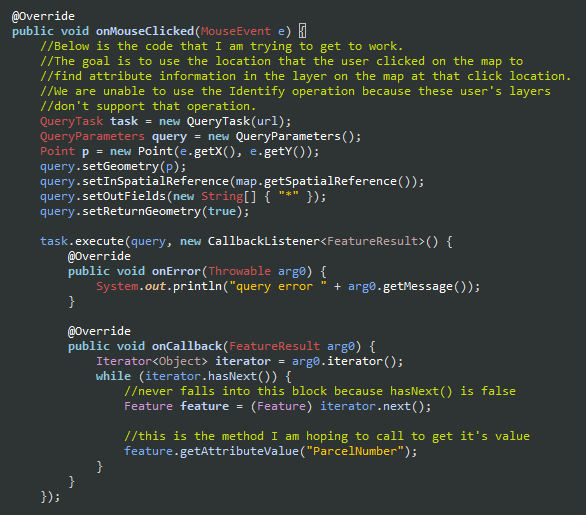

How do I find attribute information from a layer at the location a user clicks on the map without using the Identify operation?
1098
08-04-2017 02:02 PM
KaitherHoliway
Deactivated User
The following code is not working:

Hi,
Check this snippet as a reference:
@Override
    protected List<ArcGISFeature> doInBackground(String... string) {
        publishProgress(0);
        List<ArcGISFeature> listFeatures = new ArrayList<>();
        try {
            QueryParameters query = new QueryParameters();
            query.setReturnGeometry(true);
            query.setWhereClause("Name <>" + "'" + DisplayMap.getSharedPreferences().getString(Settings.USER_NAME, "") +"'");
            Polygon ply = GeometryEngine.buffer(usrLocation, 600);
            query.setGeometry(ply);
            query.setSpatialRelationship(QueryParameters.SpatialRelationship.INTERSECTS);
            query.setMaxFeatures(30);
            ListenableFuture<FeatureQueryResult> future = mServiceFeatureTable.queryFeaturesAsync(query);
            FeatureQueryResult result = future.get();
            Iterator<Feature> iter = result.iterator();
            while(iter.hasNext()){
                ArcGISFeature f = (ArcGISFeature) iter.next();
                f.loadAsync();
                if(!f.getAttributes().get("Name").equals(DisplayMap.getSharedPreferences().getString(Settings.USER_NAME, ""))){
                    listFeatures.add(f);
        } catch (InterruptedException | ExecutionException e) {
            e.printStackTrace();
        } finally {
            return listFeatures;
Hope this helps
