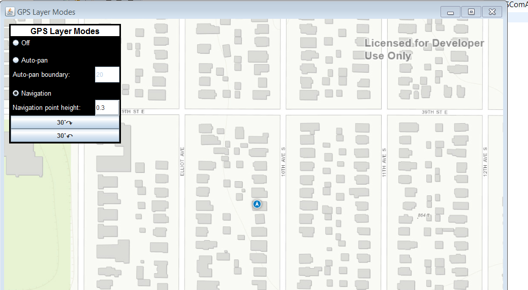

Does anyone have a quick example on how to turn the graphicLayer (gpsLayer) to a real gpsLayer in the
GPSComApp example code? I would like to keep the sample code as intact as possible but I would like to enable navigation or autopan modes on the graphic in this application.

Tom,
Look at GPS Layer modes example. Just initialize GPSLayer with SerialPortGPSWatcher. It should work.
GPSEventListener gpsListener = new MyGeoPositionListener(jMap, graphicsLayer);
gpsWatcher = new SerialPortGPSWatcher(gpsListener);
gpsLayer = new GPSLayer(gpsWatcher);

thomasbales
Thanks, worked like a charm. I am directly connected to the feed on my GPS hardware.
