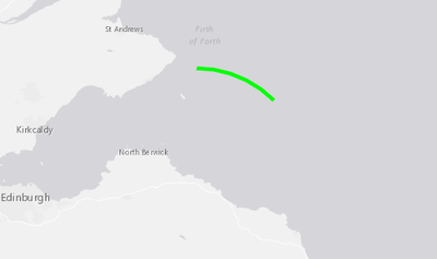

I've written some basic code to show this in action where I've drawn a 45degree arc (converted to radians) off the East coast of Scotland.
    // set up spatial references
    SpatialReference wgs84 = SpatialReferences.getWgs84();
    SpatialReference webMercator = SpatialReferences.getWebMercator();
    // make a point in lat/long (WGS84)
    Point centrePoint = new Point(-2.5,56, wgs84);
    // project it to a mercator projection where the unit of measure is metres
    Point mercatorPoint = (Point) GeometryEngine.project(centrePoint, webMercator);
    // create an arc segment which is 50Kilometers radius, starting at 90 degrees, the arc angle is 45 degrees clockwise
    EllipticArcSegment arcSegment = EllipticArcSegment.createCircularEllipticArc(mercatorPoint, 50000,Math.toRadians(90), Math.toRadians(-45), webMercator);
    // make a part with the segment
    Part part = new Part(webMercator);
    part.add(arcSegment);
    // create the line from the part
    Polyline line = new Polyline(part);
    // add it to a graphic and graphics overlay to allow us to visualise it
    Graphic arcGraphic = new Graphic(line, lineSymbol);
    graphicsOverlay.getGraphics().add(arcGraphic);
The result looks like this:
Does this help?
Does this help?
