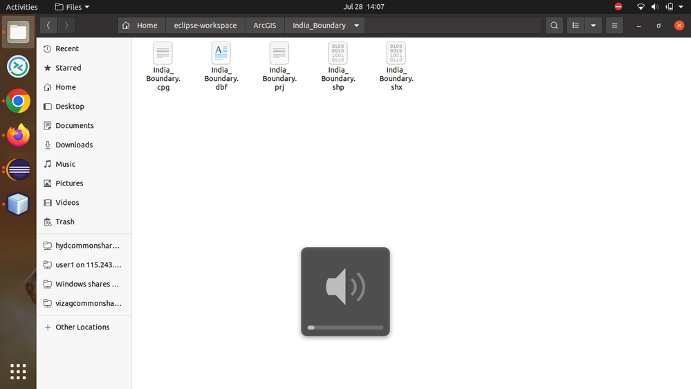

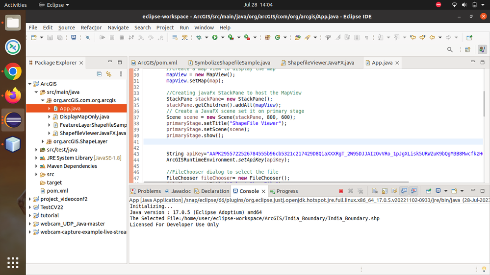

i set up everything like APIKey and ArcGIS RunTIme Environment and javaFX also but while im running the code provided by the  official esri documentation , im not getting any display output i tried to display the ArcGIS basemap it was working but while im reading the Shapefile was not giving any output, i'm keep on trying but not getting any result.

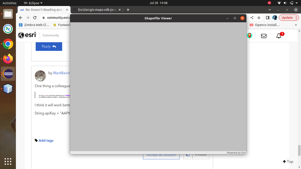

Screenshot from 2023-07-28 14-07-38.pngSame blankframeSame blankframe
i tried sir but same result not displaying anything.

The API key needs to be set earlier in the app.  Make it the very first thing that happens before you use any of the esri mapping funcationality.
PRAVEENPATNANA
beautifully Working with your valuble suggitions sir, i Made it the  API key very first thing that happens before use of esri mapping.
