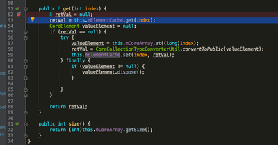

The cause would appear to be that size() returns (int)this.mCoreArray.getSize() while get(int) indexes this.mElementCache, which at the time has size == 0 because mCoreArray was empty when the UnmodifiableListImpl was constructed.
While UnmodifiableListImpl is an unmodifiable wrapper, the CoreArray it adapts is evidently mutable. Nothing wrong with that - its just that the assumption encoded in get(int) is invalid.
