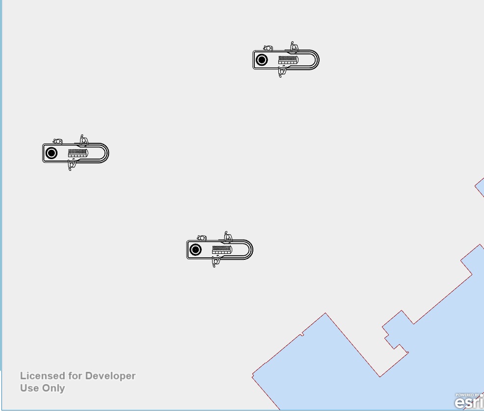

So this code produces a correctly rendering pair of layers:
layer = new ArcGISLocalDynamicMapServiceLayer("C:\\synergyii\\gisdata\\All Floors.mpk");
map.getLayers().add(layer);
layer = new ArcGISLocalDynamicMapServiceLayer("C:\\synergyii\\gisdata\\AdvancedGraphic-1471274891125.mpk");

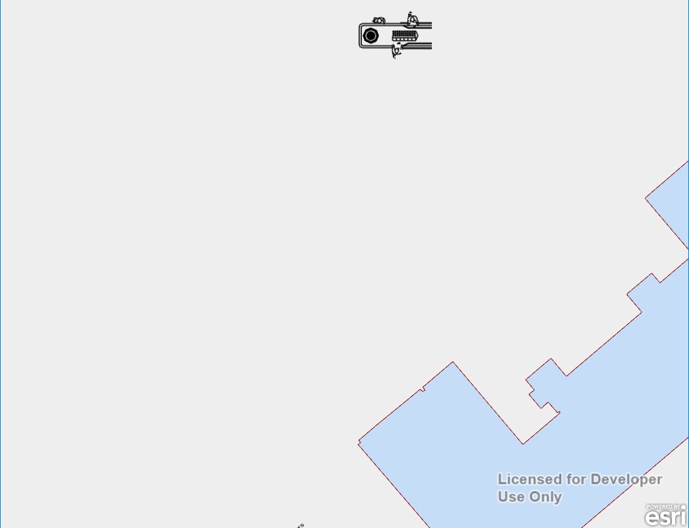

This code produces an incorrectly rendering pair of layers:
layer = new ArcGISLocalFeatureLayer("C:\\synergyii\\gisdata\\AdvancedGraphic-1471274891125.mpk", 0, true, RenderingMode.DYNAMIC);
As you can see only one geometry is actually showing here and its incomplete. If you pan and zoom around the map the rendering changes each time.
Does anyone have any ideas why the ArcGISLocalFeatureLayer is giving me rendering issues?
