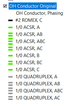

In my TOC, I have a layer named OH Conductor Original.  Within that layer are several conductor types.
When I set up my legend, I only want certain conductor types to be displayed in the legend (but all drawn on the map) but I have yet to find a way to exclude certain unique values.  Can this be done?

short of reclassifying your data, the only other way is to convert the legend to graphics and delete the pieces you don't want (ungroup the graphics to get down to the individual element level, then you can regroup when you are done.

Converting to graphics is the last thing I wanted to do since I have several maps to make and the legend will change with each one. I think I’ve found a work around though. I just figured there would be a better way to accomplish this as it seems like a pretty simple task.

You could add the layer again, symbolized as you'd as a separate layer to the service.

Thank you for the advice. I believe this to be similar to what I ended up doing.
