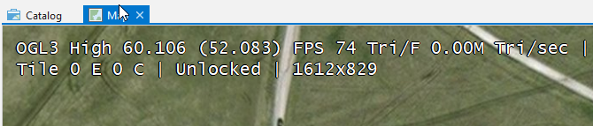

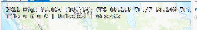

Doing this activates DirectX/OpenGL and the GPU over RDP. You can confirm it's working by launching ArcGIS Pro, opening a map, then hitting Shift + E, this will display the rendering information for your ArcGIS Pro session.
DirectX
OpenGL
