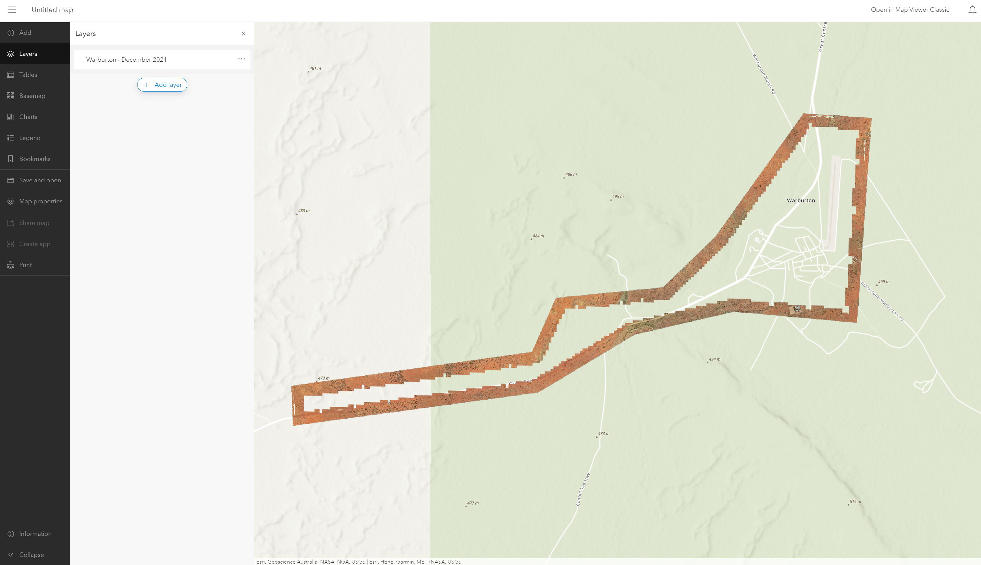

Hi all,
I am hoping you can tell what might have caused this look? As I zoom in cache levels are available but not all there.

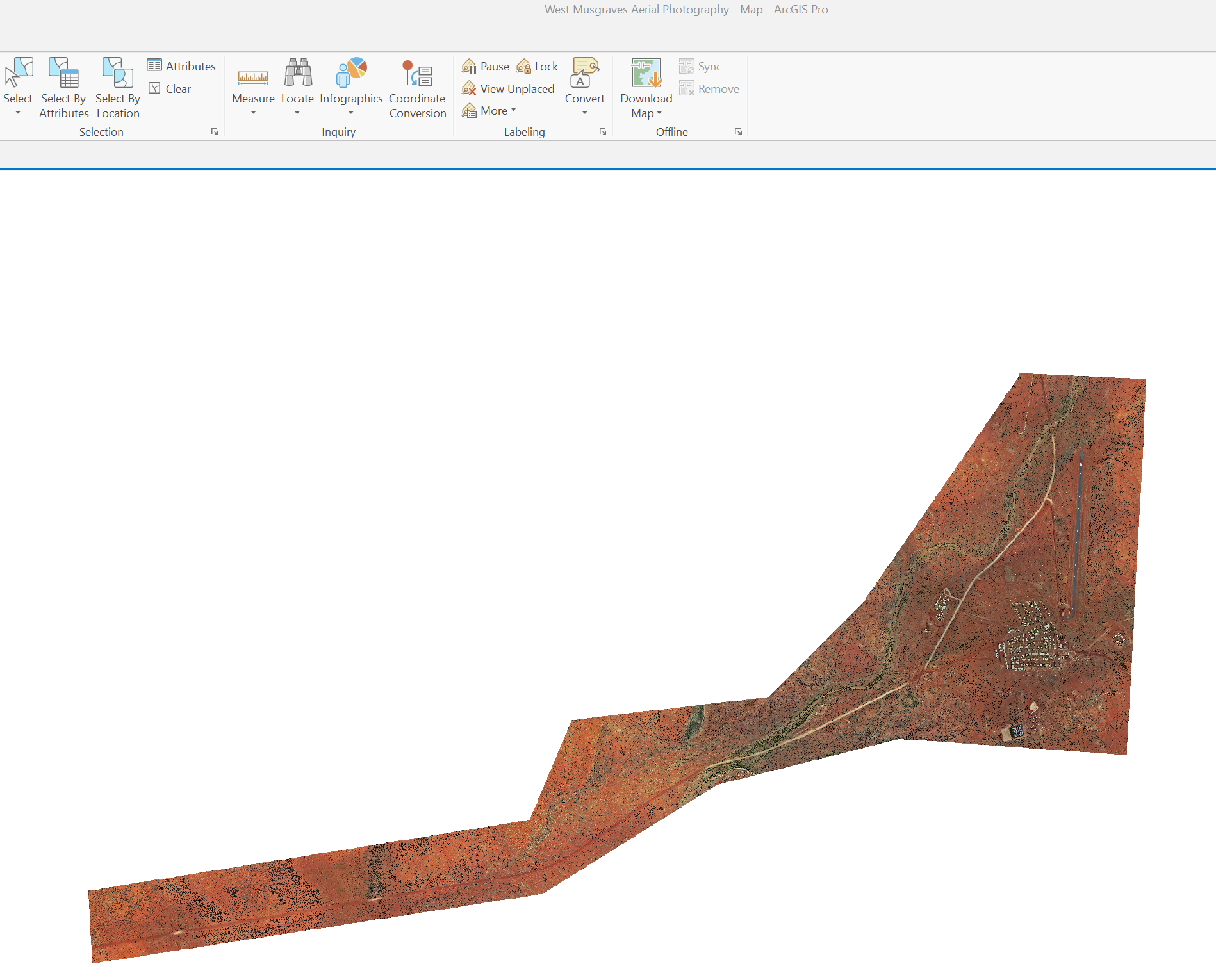

This is a tile image (single image). I uploaded a Tiff (see below in ArcGIS PRo)
Is this a case of simply republish or something more sinister?
Thanks in advance,

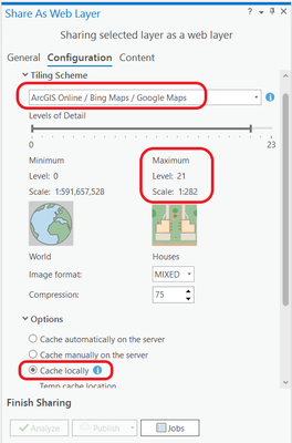

@GWaltersOZ so did you share the Tiff to AGOL in Pro using "Share as Web Layer"? Assuming you defined the cache correctly at the point of sharing in Pro, setting a range of cache levels, then the TPK should upload to AGOL and begin building the hosted cache.

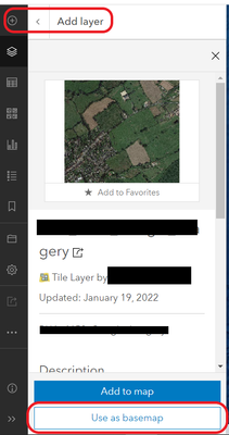

If you didn't set the tiling scheme to match agols standard scheme, then it wont display properly in AGOL if you add it in as a layer, as the zoom levels wont match the tiling scheme of the basemap. If that's the problem, you can confirm this by adding your tiff tile layer as a basemap into the new map viewer:

When I said 'they are all available, but not there.' I meant that the tiles were not visibile, as you could see from the original screenshot, but as I zoomed in different layers had been rendered.
