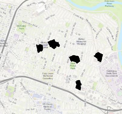

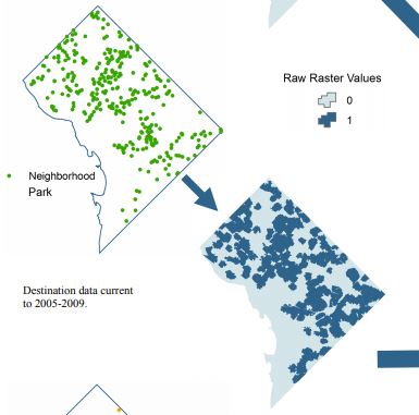

Hi folks, I am trying to perform a walkability analysis for Sacramento, CA. I converted the service area polygon shapefiles for each locations in Sacramento into raster layers. However, I need to have my raster layers within a boundary like the figure on the left, so I can define raw raster values of 0-1. Right now, my polygon shapefiles & raster layers are stand alone so they only have a single value of 1.
Does anyone know how to do this? Am I supposed to create the boundary with the service area polygons before I convert them to raster?
Thank you!
mneer
If you are trying to create a 'boundary" from the raster you can use the "raster to polygon" GP tool found in the conversions tools set->From Raster-> "Raster to Polygon"
If you are trying to Clip them based on a boundary just do a "clip raster" GP tool.  found in Raster->Raster Processing->"Clip Raster"
Clip Raster—Data Management toolbox | Documentation
Raster to Polygon—Conversion toolbox | Documentation
JeromeWu
I figured it out. I had to Reclassify my raster layers and specify the processing extent and raster analysis mask.
