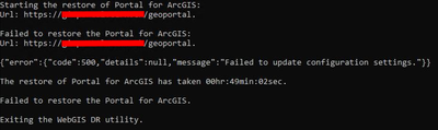

Hello,
Since I upgraded from 10.9.1 to 11.0, my webgisdr restore tests start failing for Portal for ArcGIS with the error message "Failed to update configuration settings.":
Here is the relevant Portal for ArcGIS logs:

<Msg time="2022-10-29T23:10:58,92" type="INFO" code="209201" >Failed to update configuration settings. This connection has been closed.</Msg>
<Msg time="2022-10-29T23:10:58,94" type="SEVERE" code="209044" >Upgrade failed. Failed to update configuration settings.</Msg>
<Msg time="2022-10-29T23:10:58,98" type="INFO" code="209074" >Connection file deleted from disk.</Msg>
<Msg time="2022-10-29T23:10:58,112" type="SEVERE" code="209044" >Upgrade failed. com.esri.arcgis.portal.admin.core.site.migration.MigrationException: Failed to update configuration settings.

I then tried manually to 'importSite' rather than the full webgisdr process: same issue.
