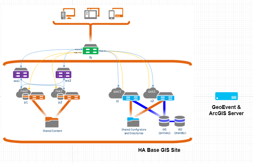

This would be our Portal and ArcGIS Server high availability deployment.
We want to add a HA GeoEvent Server to this architecture. What would be the best solution based on the following limitations/recommendations?
1- Don't use multi-machine sites with GeoEvent
2- Don't install GeoEvent in your base GIS site
If we create two independent GeoEvent site, we should sync them manually? Any better solution?

Hello Azin -
The ArcGIS Server documentation includes reference architectures for deploying additional server roles (such as GeoEvent Server) to your ArcGIS Enterprise.  The terms I'm using here are consistent with the 10.5.x product release. There are reference architectures for high availability as well as for GeoEvent Server.
Based on the icons you included in your system architecture illustration, I might assume you've seen these references - but I wanted to make sure.
I would point out that the reference architecture for GeoEvent Server which depicts a horizontal scale-out deliberately has white space between the machines:
Additional server deployment - GeoEvent Server
The white space is intended to depict your first stipulation -- that you do not 'Join Existing Site' when installing the GIS Server component of ArcGIS Server with the intention of later installing GeoEvent Server. Each of the three GeoEvent Server machines depicted above exist in their own site. They do not know anything about one another. This is to prevent leveraging a concept we refer to as "GeoEvent Clustering" which we introduced with the 10.3 release. Changes to address some issues were included with the 10.4 release. We eventually realized that the concept was fundamentally not working as we intended, and the advice now for releases 10.3 / 10.4 / 10.5 is to not have more than one GIS Server in a site when GeoEvent Server is installed.
We are working on developing a "Gateway" component for 10.6 with the intent that GeoEvent Server will again offer some resiliency and improved scalability. However, until then, your challenge is to figure out how to configure an external component to handle event distribution to two or more instances of GeoEvent Server which do not know anything about one another.

Yes, with the introduction of the GeoEvent Gateway, system architects again have the option of deploying GeoEvent Server with multiple machines configured as part of a single ArcGIS Server site. The recommendation is still that your ArcGIS Enterprise be deployed separately allowing you the flexibility to scale the GIS Server component for map and feature services.
The only real change to the diagram would be to de-emphasize the white space between GeoEvent Server instances:
Above, I'm illustrating that a GeoEvent Gateway, running on each ArcGIS Server machine, will coordinate through the ArcGIS Server site dedicated for real-time event processing to distribute events processing across the three machines.
There are still a number of questions to prove out here. What if a solution were being designed which had several, independent, inbound feeds whose velocity and/or event volume were each nominal (no more than 1,000 or 2,000 events per second)? Such a use case wouldn't require an event distribution mechanism to leverage several machines. It might be better, in this case, to follow the 10.5 / 10.5.1 pattern of deploying independent instances of GeoEvent Server in separate sites, dedicating instances to handle one or two independent inbound data streams. The above single-site, multi-machine approach would be recommended only if you were deploying 10.6 and had a single inbound event stream whose velocity / event volume were too much for a single server to handle.
