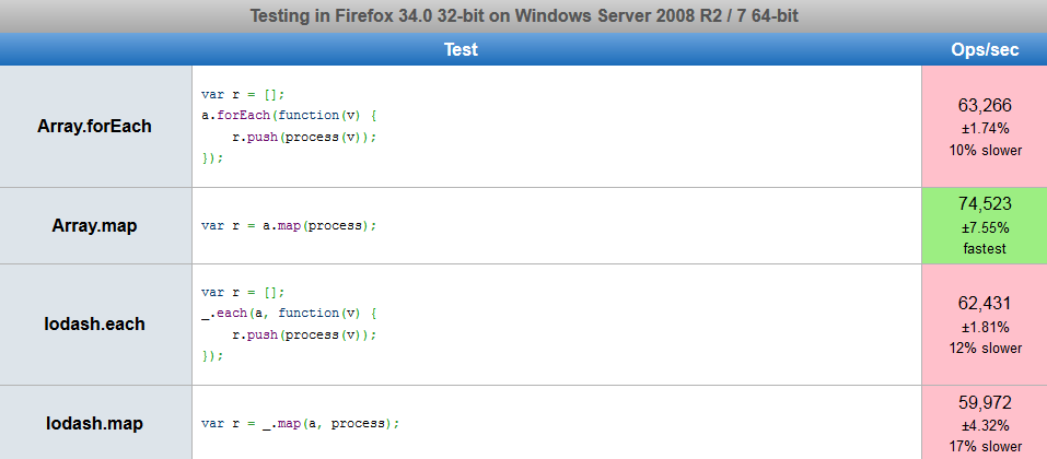

Native methods aren't always faster...
native vs lodash · jsPerf
JeffJacobson
stevegourley
silly firefox. well, native methods aren't always faster on every browser. They also don't have feature parity with the 3rd party implementations. Anything lazy would be much more noticeable. Either way, here's a grain of salt.
