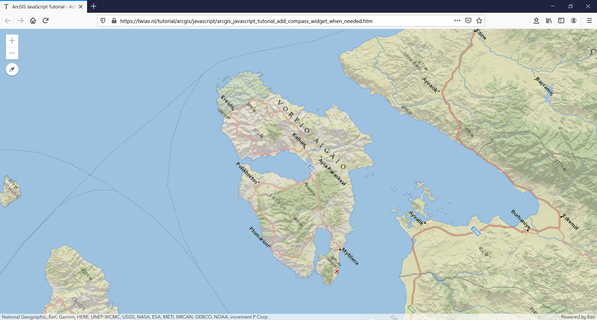

In the sample below we only add the Compass when the user rotates the map (be it by accident or on purpose). And the moment the compass orientation has been reset to 0 we remove it again.
To check the orientation of the view we use watchUtils like this:
watchUtils.whenTrue(view, "stationary", function() {
  if (view.rotation == 0){
    view.ui.remove(compassWidget);
  } else {
    view.ui.add(compassWidget, "top-left");
Below you will find the full code of this sample, and you can view it live:
ArcGIS JavaScript Tutorial - Add Compass Widget only when needed
