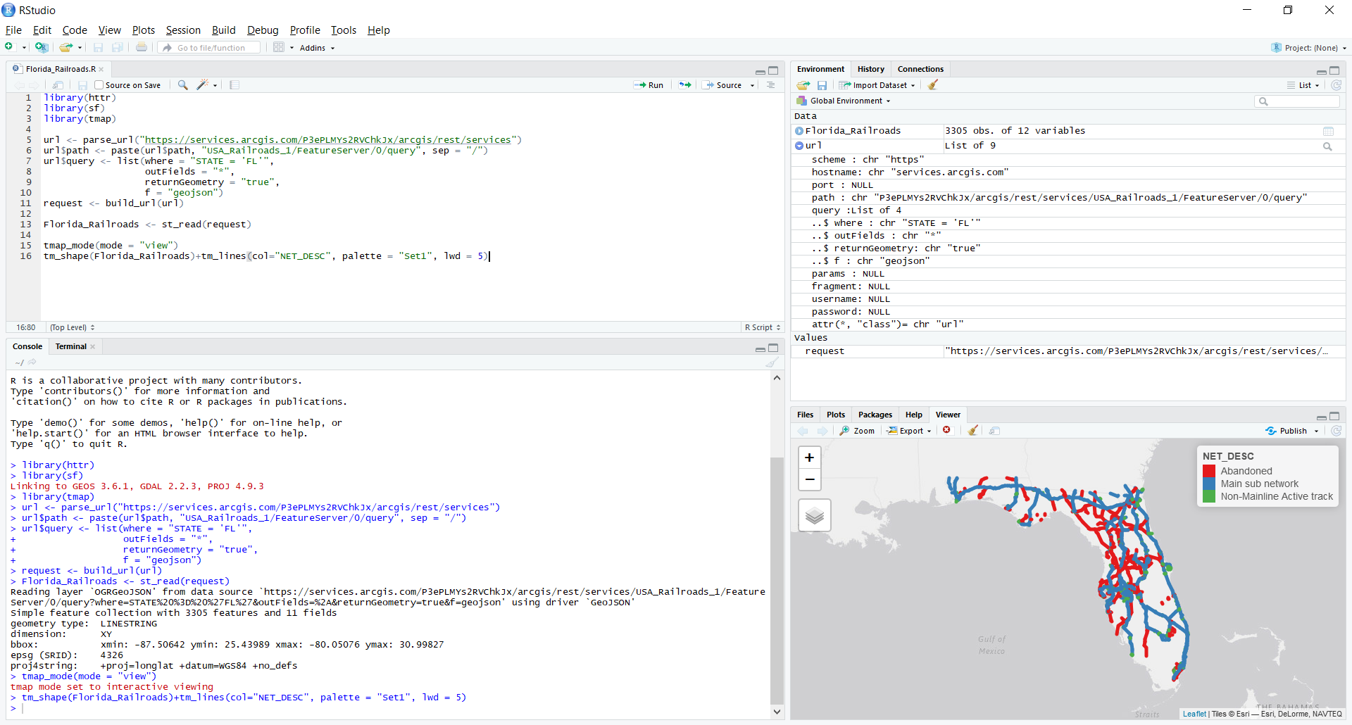

In the screen dump below we can see that the total number of records returned is 3305, which is well beyond the maxRecordCount (1000) for this Feature Layer. The GDAL library, which is used by the st_read() function in the sf package, provides automatic paging. Nice, isn't it?
With the last two lines in the script we create the interactive map in the Viewer in RStudio.
So, the answer to our question is: "Yes, there are quite a few abandoned railroads in Florida". These abandoned lines are marked in red in the map in the screen dump below.
