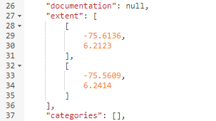

Your webmap | ArcGIS for Developers will have a property called extent | ArcGIS for Developers that will provide the default extent:
You can use the coordinates to create a polygon: Geometry objects—Common Data Types | ArcGIS for Developers and do your validation.
https://developers.arcgis.com/web-map-specification/objects/webmap/
