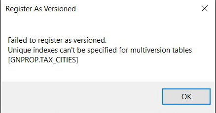

I have an existing table in an oracle enterprise GDB, when I try to enable this table as versioned, I get an error that says: "unique indexes cannot be specified for multiversion tables".
What might be the issue here?
