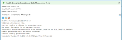

Observed the same issue with the Database name with DOT ".", Once I replace the database name with "_" GP tool is working fine and enterprise Geodatabase created and configured.
AvinashPatel
I have observed the same issue with Database Name, Once the DB name is removed with the "-" GP tool works fine.
ALTER DATABASE "DB_Name" SET READ_COMMITTED_SNAPSHOT ON;
ALTER DATABASE "DB_Name" SET ALLOW_SNAPSHOT_ISOLATION ON ;
With new name
