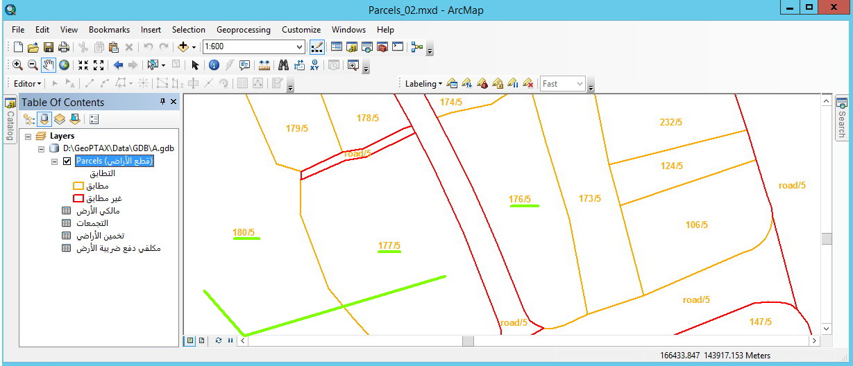

1- How the labels appear with the join

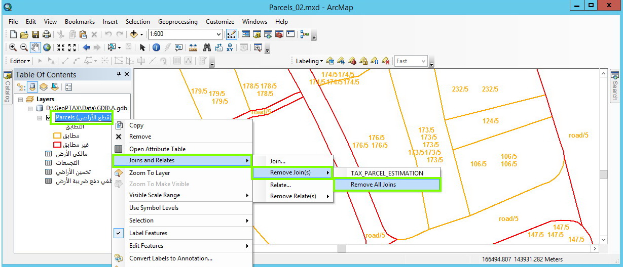

2- Removing the join

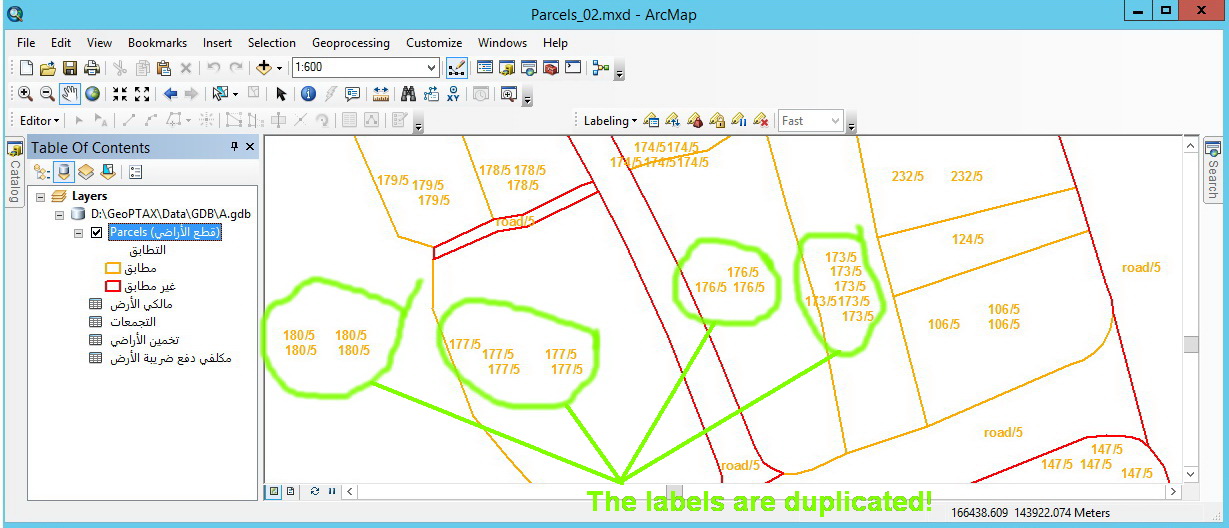

3- The labels work well!
