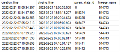

If you run a select query on the states table in SSMS or Toad, is there only a single record referring to state 0?
HeatherScroggins
Hi Kim,
Yes there is only a single record referring to state 0. Here is a screenshot of the states table from first thing this morning.
KimberlyGarbade
Sorry, just a quirk of English (and it's the only language I know), but I meant is there only one record in the entire table and does it reference parent_state_id zero?  This would mean that you have reconciled and posted all child versions up to default and then compressed the database to get it to "state 0".  The reason I asked was because I got the impression that this is what you were trying to do, and if it had succeeded (and there was only state zero represented in the table) it might have given us a clue as to the "Target state not found.." message...I.E. that it didn't make a lot of sense given your database state. However, the table seems to indicate versions still exist, so the message is probably correct.
